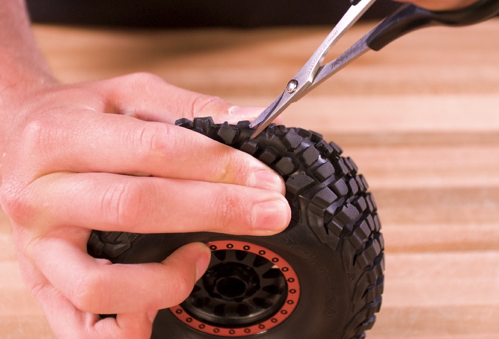

Start by cutting a small hole in the tires with a sharp pair of body scissors. Pinch the tire to create a crease in the middle and then cut a V shape on both sides to make a small rounded hole. Rotate the tire 180 degrees and do the same on the other side. If you have a lot of sand in the tires, try to shake out as much as you can. As the truck is running, sand will automatically be flung out of the holes.

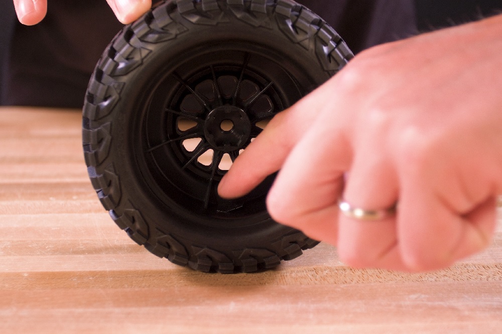

After you have cut the holes to let the sand out, use small squares of duct tape to cover up the breather holes in the wheels. This will help keep the sand out. Also inspect the tire bead. Make sure the tire isn’t separating away from the rim and letting sand inside. If so, take this opportunity to clean and reglue the tire back to the rim.
