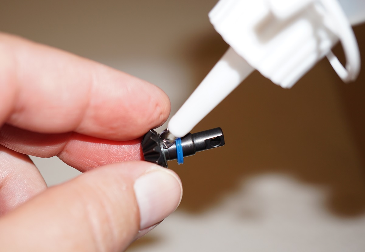

apply oilApply differential oil to the X-rings
Apply a small amount of differential oil onto the output shaft followed by the PTFE washer and blue X-ring before inserting it into the carrier. This will help prevent the X-ring from tearing during the assembly process and provide a good seal. Insert the shaft through the carrier and then fill the carrier approximately one-quarter full of differential oil.

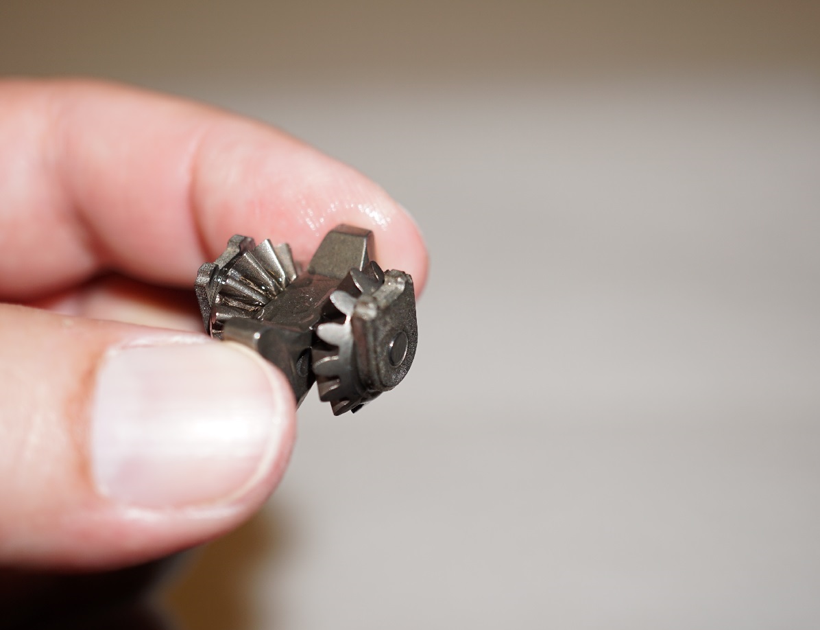

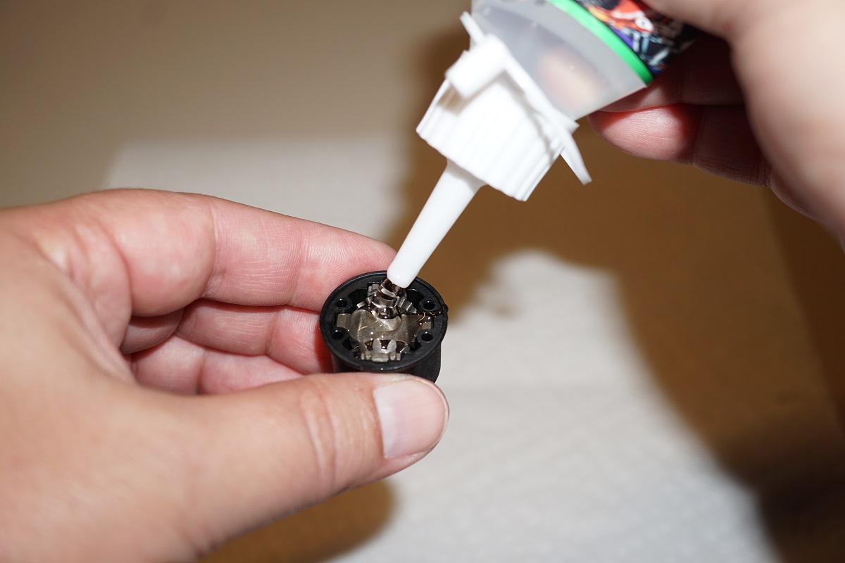

Assemble the gearsAssemble the internal differential gears
Notice that the upgraded XO-1 internal differential gears feature a large steel brace for extra support. The brace only fits in one way so it’s best to do a test fitting before final assembly. Apply oil to all of the internal parts as you assemble them. This helps lubricate them, but also makes assembly easier if they all stick together.
Fill the differentialFill the differential carrier with oil
Press the completed gear assembly down into the carrier and turn the output shaft. This will coat the gears in the differential oil at the bottom of the carrier. If necessary, add a little more oil to the carrier, but do not overfill it. Overfilling the differential can cause the seal to fail when you tighten down the ring gear. Apply oil to the second output shaft and X-ring using the same technique as before and insert it through the spiral-cut ring gear.

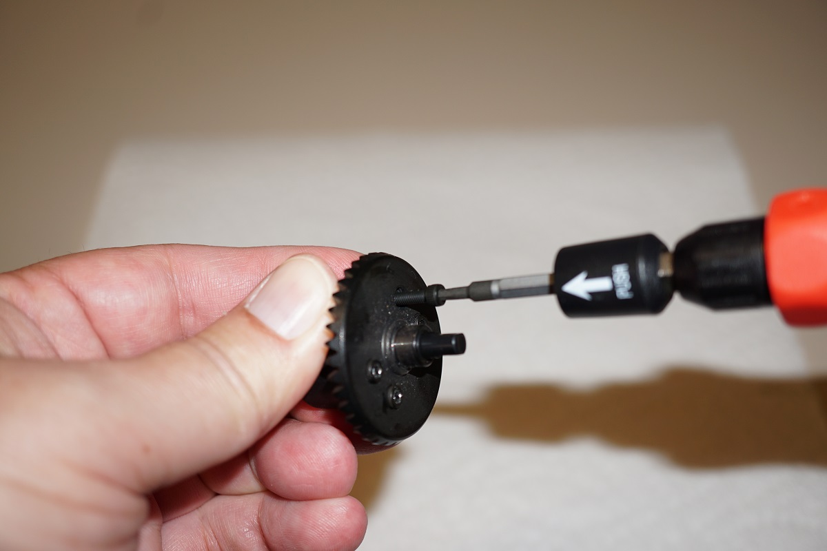

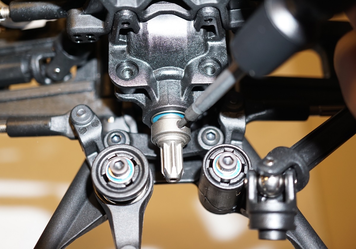

Attach the ring gearAttach the ring gear
Line up the holes in the black rubber differential seal with the screw holes in the carrier. The holes are not pre-threaded so you’ll need to add a little pressure to get the screws started. Use the 2 mm bit from the Traxxas tool kit and tighten down the ring gear onto the carrier using an "X" pattern. The handle on the driver uses a one-way mechanism to make tightening the screws easy without having to let go.

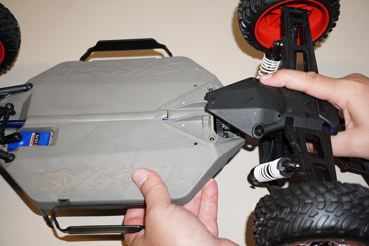

Remove the bulkheadRemove the bulkhead
Now that your differentials are ready to install, it’s time to remove the old ones. The Slash’s modular chassis makes this easy and straight forward. Begin by removing the four screws that hold the rear bulkhead. You'll need the 2.5 mm bit from the tool kit. Once those are out, you can remove the entire bulkhead assembly.

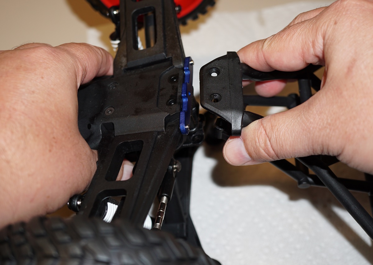

Remove the bumperRemove the bumper
With the bulkhead out, it's time to remove the rear bumper. There are five screws securing the bumper to the bulkhead. Use the 2 mm bit from the tool kit to remove them.

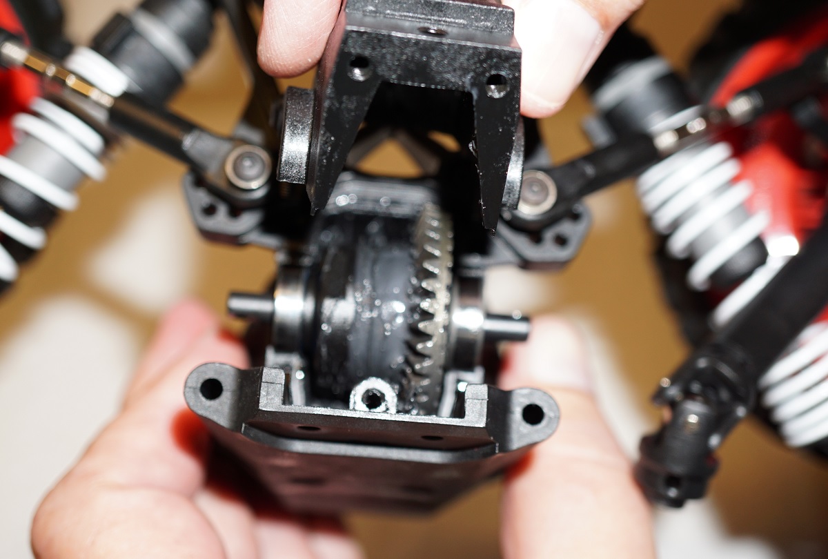

Remove differential coverRemove the differential cover
You're in the home stretch now! Remove the two screws securing the differential cover and set it aside. This will give you access to the differential carrier.

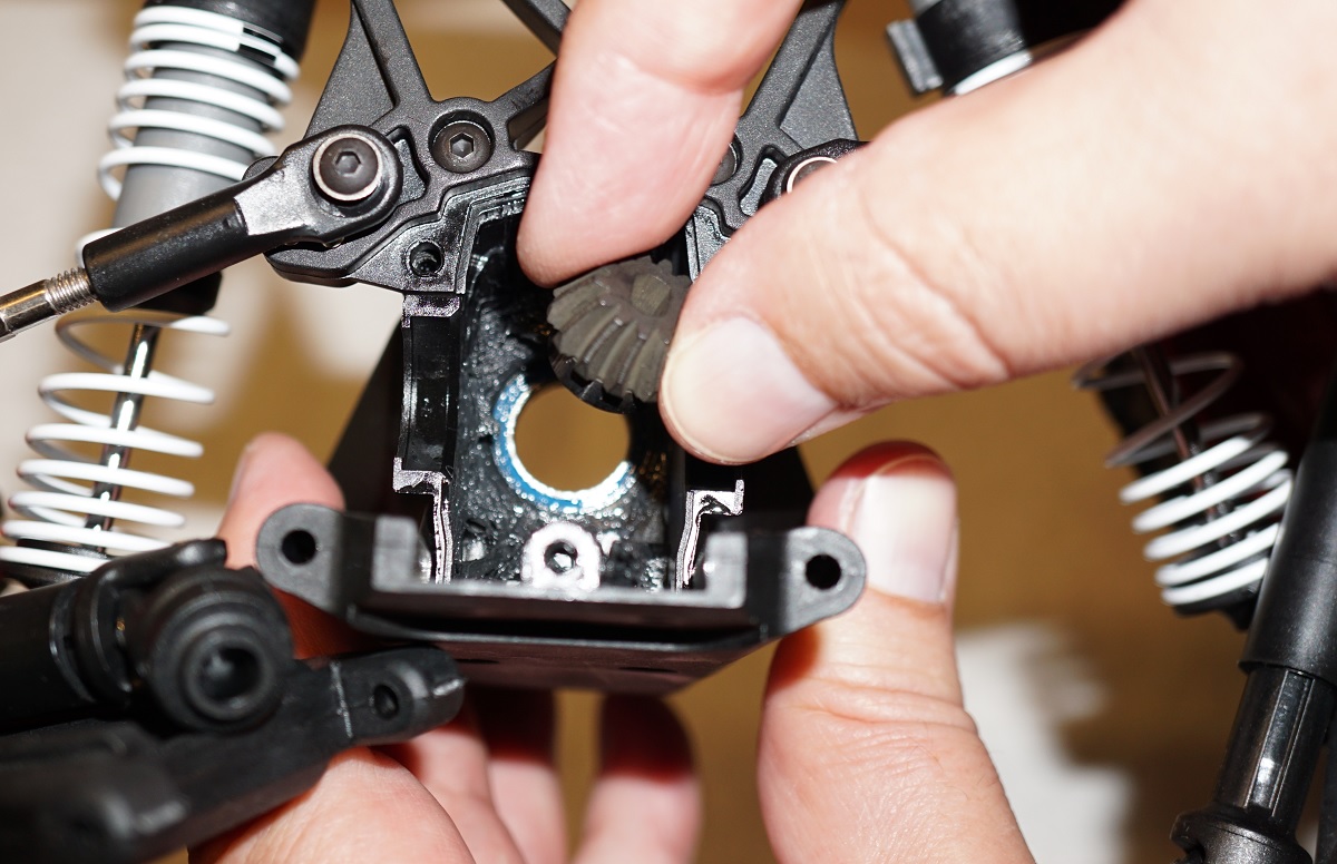

Install the pinion gearInstall the pinion gear
NOW STOP! Before you remove the differential, take note on which side the ring gear sits. It must go back in the same way or you can lock up the entire drivetrain. Remove the old differential carrier from the bulkhead. If the bearings are in good condition, reinstall them onto the new differential. Tap the old pinion gear out of the bearing holding it in the bulkhead and install the new one.

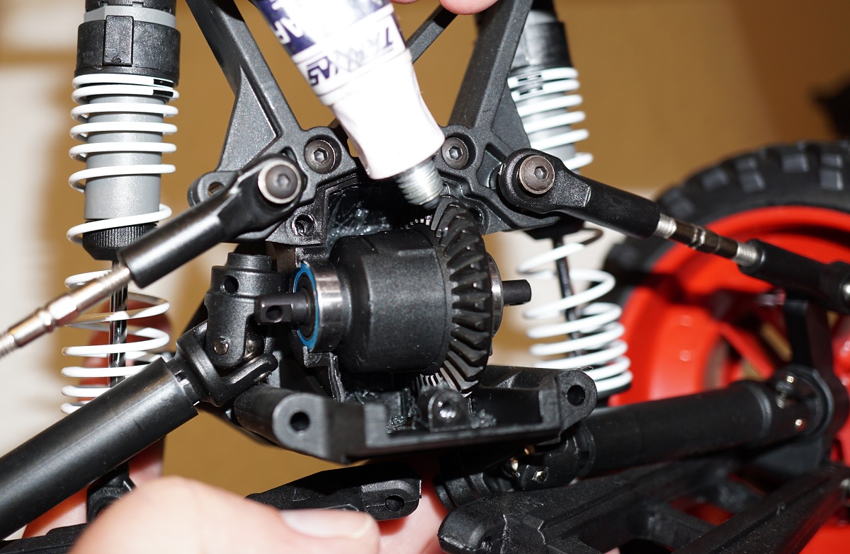

Grease the gearsGrease the gears
Once you install the new differential, it's time to grease everything up. Don't go crazy with the grease, but give everything a good coating. Reinstall the differential cover when you've finished and then reattach the bumper to the bulkhead.

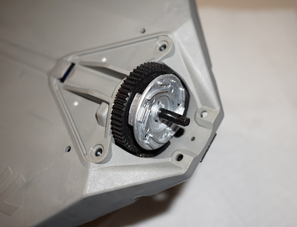

Remove the clutch assemblyRemove the clutch assembly
Now that the rear differential is complete, it's time to upgrade the clutch. The heavy-duty clutch features aluminum pads for greater heat tolerance and a much larger pressure plate to handle massive power upgrades. The old clutch assembly should pull straight out of the chassis.
Use the second holeUse the second hole

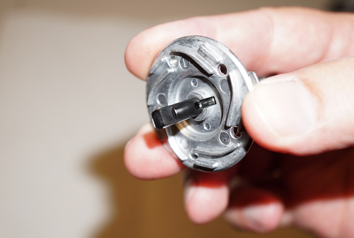

Remove the drive hub from the clutch shaft and then use the 8mm wrench to remove the locknut. This will release all the parts on the clutch shaft. Remove all the old parts and install the pin in the second hole of the clutch shaft. Slide the new pressure plate over the pin to lock it into place.

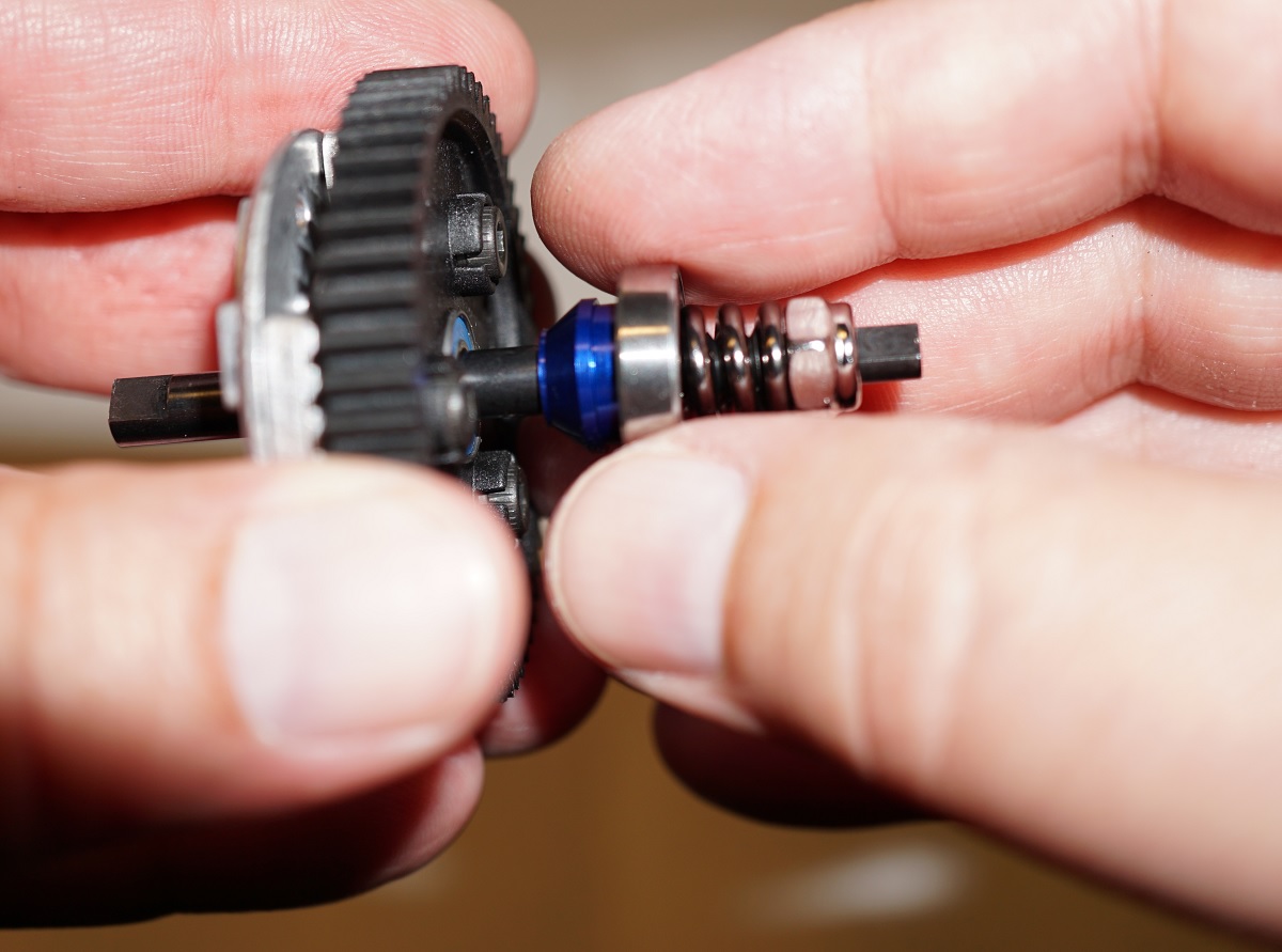

Install the bearing adapterInstall the bearing adapter
Install the new clutch disc onto the pressure plate. If your spur gear is in good condition remove it and attach it to the new clutch plate with the same three screws. Install the three aluminum pads onto the plate with the rounded edges facing away from the spur gear and then carefully press the clutch halves together. Slide the new aluminum bearing adapter and bearing onto the shaft with the tapered end facing the gear.

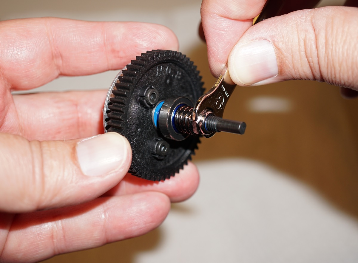

Tighten the clutchTighten the clutch
Reinstall the spring onto the shaft and then the locking nut. Hold the clutch assembly together as you tighten down the nut. Tighten the nut until you compress the spring fully and then loosen the nut about half a turn.

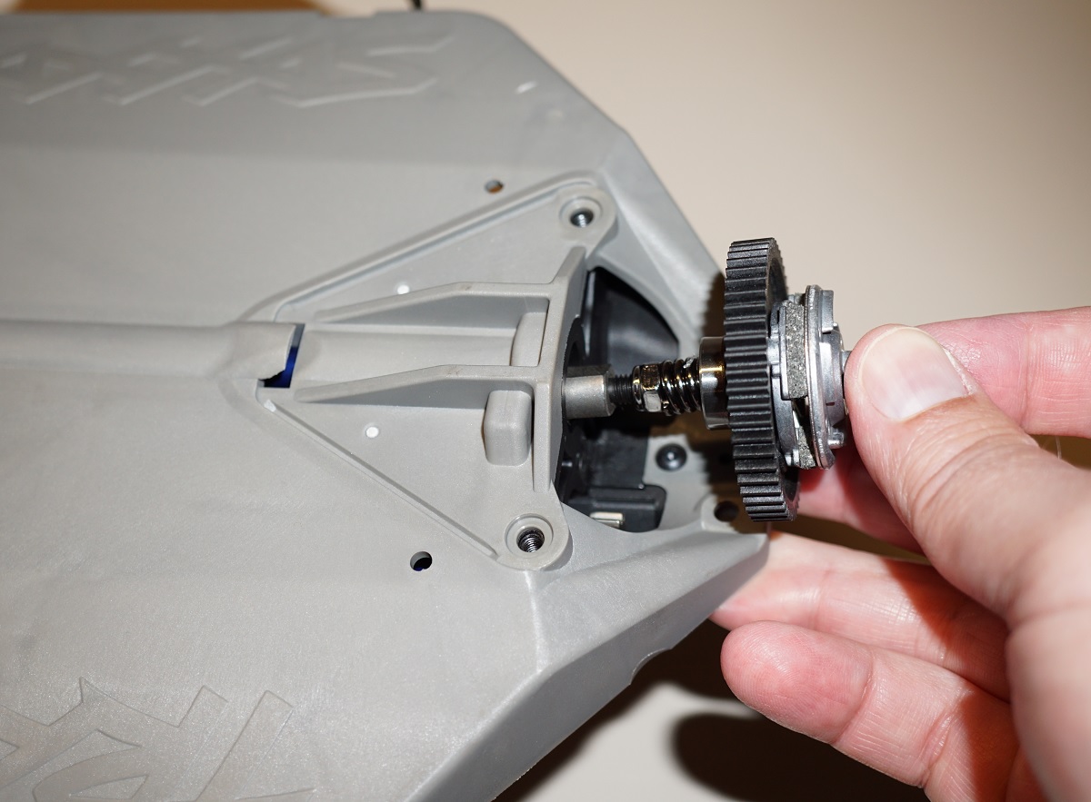

Reinstall the clutchReinstall the clutch
Reinstall the drive hub onto the end of the clutch shaft and insert it back into the chassis. You may need to rotate it slightly to align it with the center driveshaft. Once it's installed, reinstall the rear bulkhead and tighten everything down.
