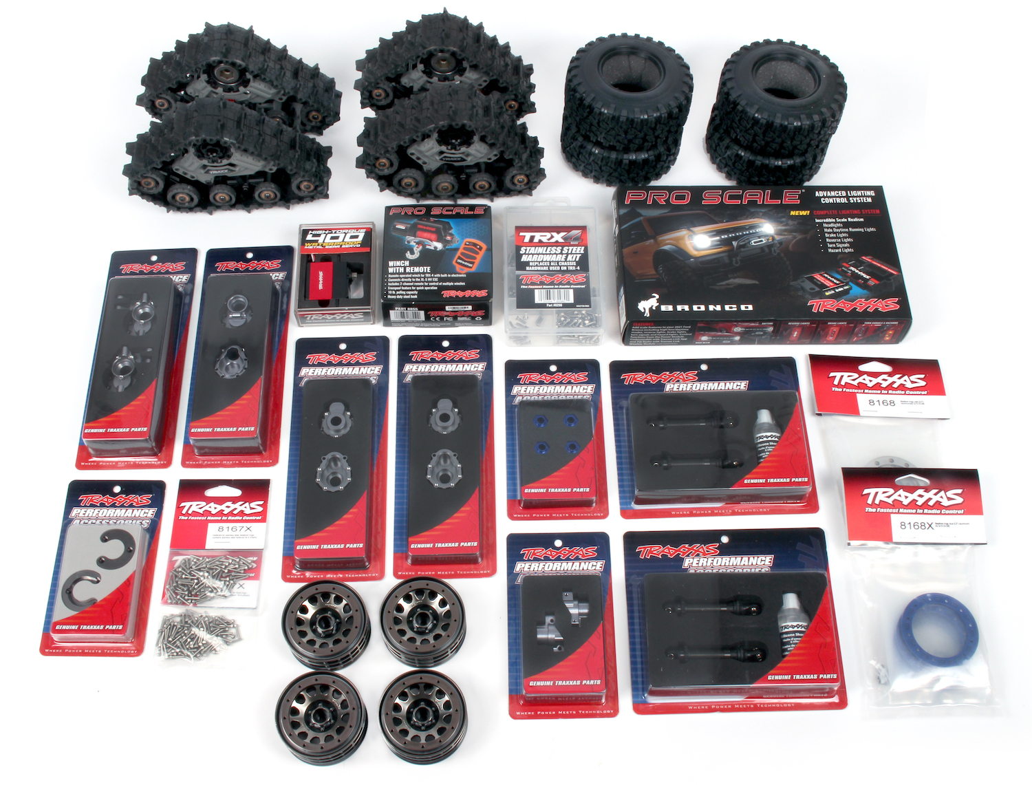

Parts layout
Here's a look at some of the accessories we'll be installing. This isn’t even everything! There’s so much you can do with a TRX-4. See all the accessories for the 2021 Bronco here.
Parts List
  • Body, Wheel & Tire
    • 8171 Method 2.2″ black chrome wheels(x2)
    • 8871 Canyon RT 2.2″ tires (x2)
    • 8168 2.2″ satin beadlock rings
    • 8168T 2.2″ black beadlock rings
    • 8167X Method 105 stainless hardware kit
    • 8023T Black high-lift jack
    • 8021 Spare tire mount
    • 8022R Blue fuel cannisters
  • Drivetrain & Suspension
    • 8252A Gray aluminum front inner portal housings
    • 8253A Gray aluminum rear inner portal housings
    • 8256X Blue aluminum portal drive mounts
    • 8251A Gray aluminum outer portal housings (x2)
    • 8232X Blue aluminum caster blocks
    • 8290A Gray aluminum motor mount
    • 8061 Chromoly axle shafts (rear)
    • 8062 Chromoly axle shafts (front)
    • 8279R Machined ring and pinion gear (x2)
    • 8280X Chrome differential cover
    • 8267 Portal weights
    • 8260X Anodized GTS shocks (x2)
    • 8269X Blue aluminum hubs
    • 1747R Blue wheel nuts
    • 8298 Stainless hardware kit
    • 8880 Deep-terrain Traxx
  • Lighting & Electronics
    • 9290 Pro Scale® LED light set
    • 2255 High-Torque 400 Red servo
    • 2262 High-Output BEC
    • 8855 Pro Scale® Winch
Add All Accessories to your cart with one click!

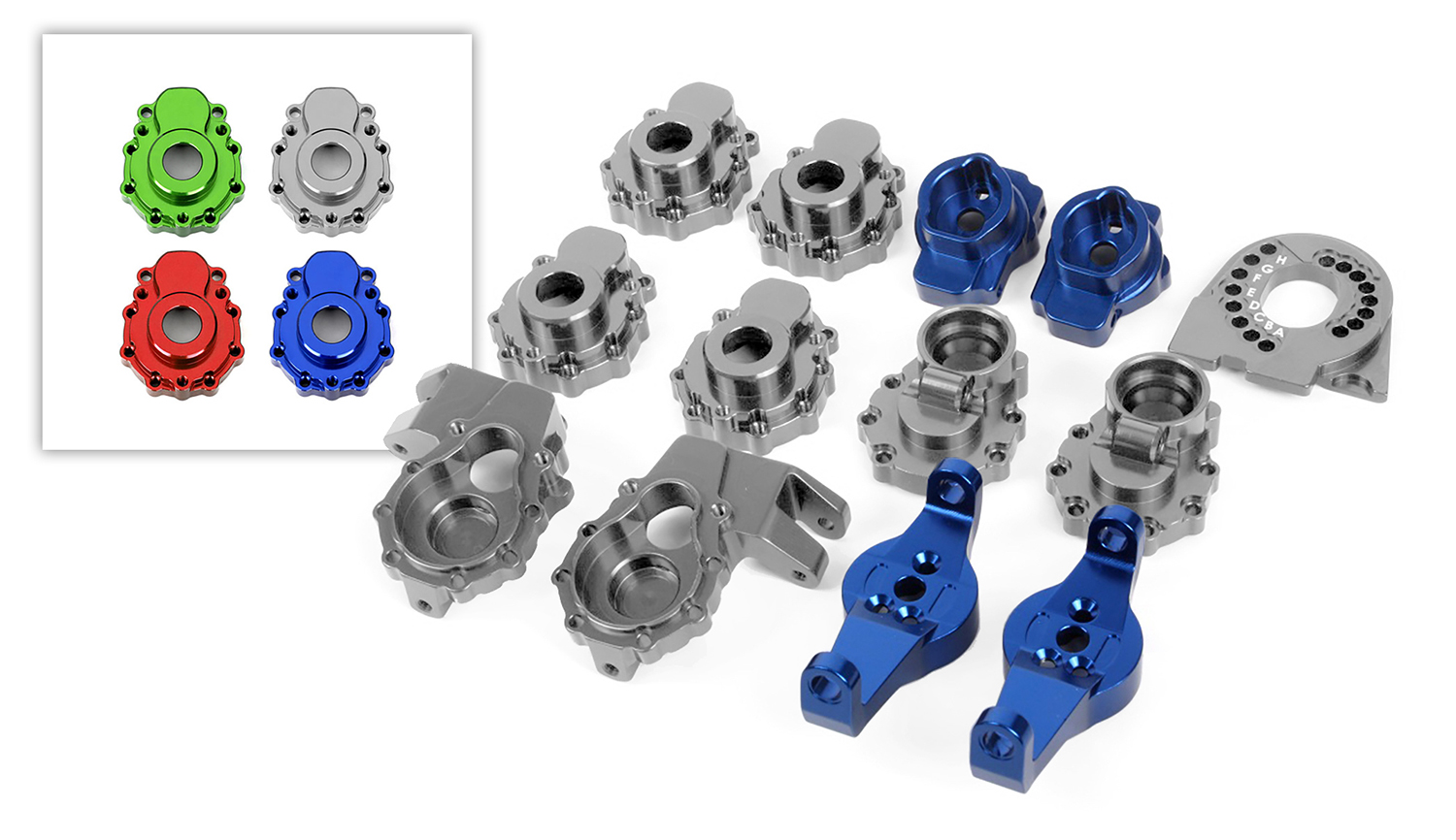

Aluminum accessoriesYou can get the TRX-4’s machined aluminum accessories in red, blue, green, and charcoal gray. We’re going with charcoal gray and a few pops of blue for this build.

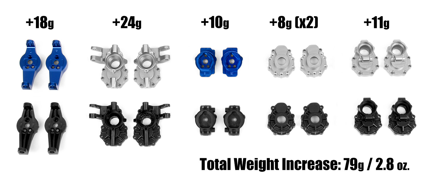

Lowering the CG
The machined aluminum axle parts increase strength, and of course they look terrific. The aluminum parts also add nearly three ounces to the truck’s overall weight to boost climbing and crawling traction. Adding the weight to the axles lowers the Bronco’s center of gravity. You can see the breakdown in the image below.
Adding weight for stability
Adding weight onto the axles lowers the Bronco's center of gravity and increases stability.

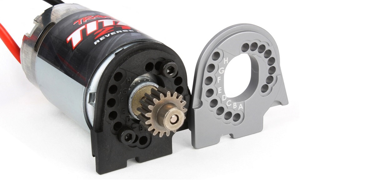

Aluminum motor plate
It’s invisible once installed, but the aluminum motor plate is a smart upgrade for flex-fighting strength and a bit of extra cooling as the aluminum pulls heat from the motor.

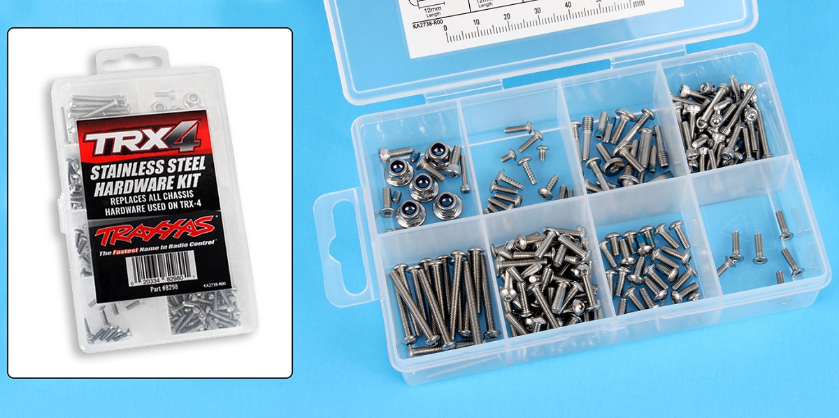

The 8298 hardware kit replaces the black-oxide fasteners found on the TRX-4 with stainless steel. You may end up with a few extra screws, depending on your model.

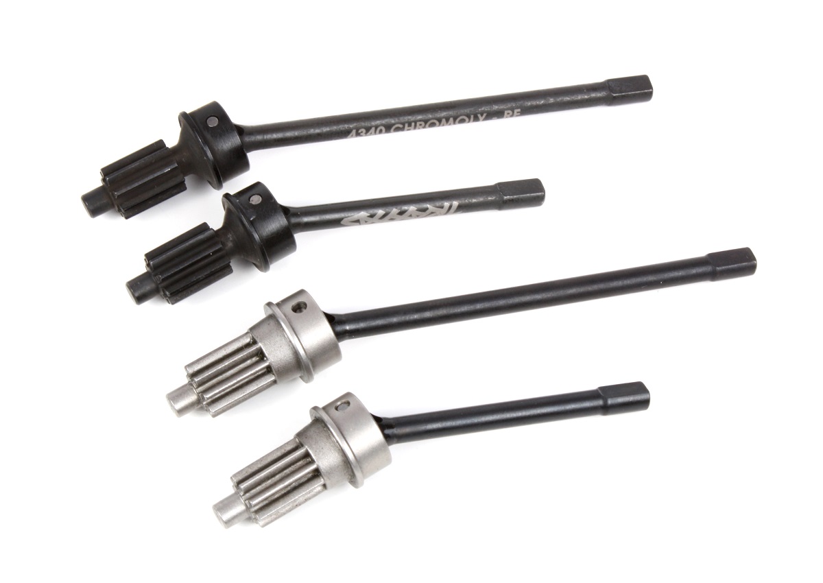

Chromoly driveshaftsHere are the chromoly axle shafts (top) compared to the stockers (which are still all-metal, but not as hard). This is a stealth upgrade since the shafts are hidden once installed, but if you’re looking for the ultimate in drivetrain strength and longevity, the cro-mo shafts are the hot setup.

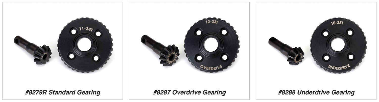

While the axles were apart, we also replaced the stock ring and pinion gears with the precision-cut machined-steel versions. We stuck with the stock ratios for all-around off-road adventuring. If a focused extreme-terrain setup is what you’re after, you can also get the steel gears with different ratios to overdrive the front axle by 11, 13, or 27%. “What’s the purpose of overdrive” you ask? Click here to learn more.
Overdrive gears
Machined-steel overdrive gears allow you to tune your truck's hill-climbing ability.

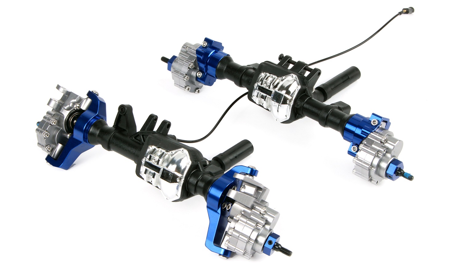

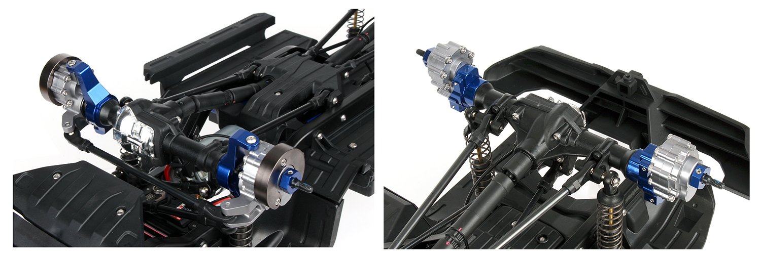

Completed axles
Here are the completed axles, ready to be reinstalled on the chassis. We also traded in the Bronco’s stock grey diff covers for chrome versions.

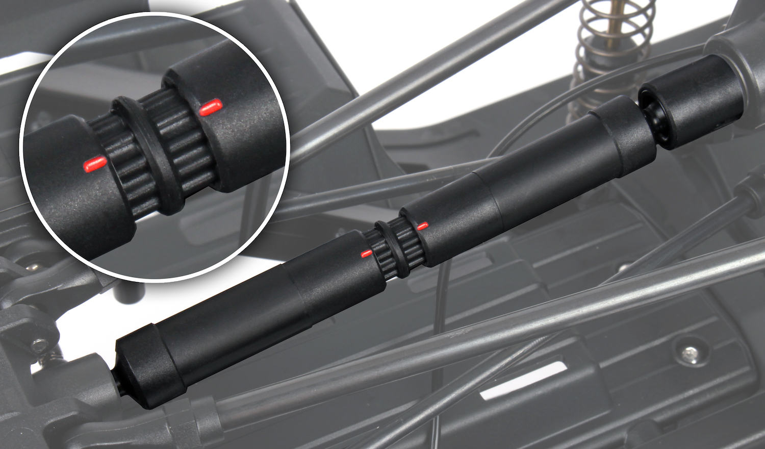

Driveshaft orientation
When reinstalling the axles, be sure to align the marks on the driveshafts to keep them “in phase”. We filled the marks in with red paint for easier visibility.

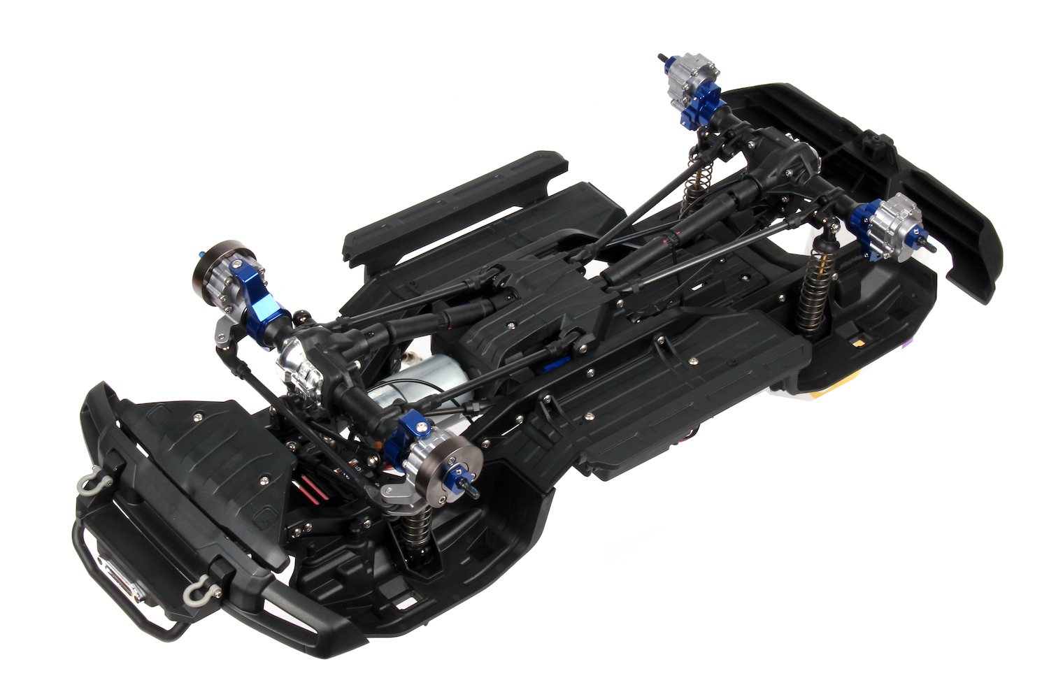

Completed front and rear axles
Completed Bronco chassis
Our Bronco’s flip side is looking good. The stainless screws add pops of silver, and they won’t rust.

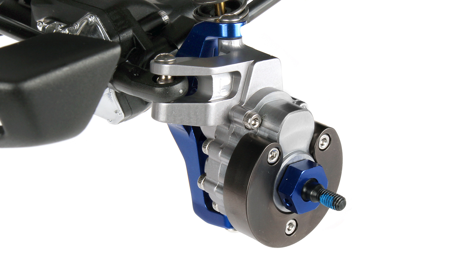

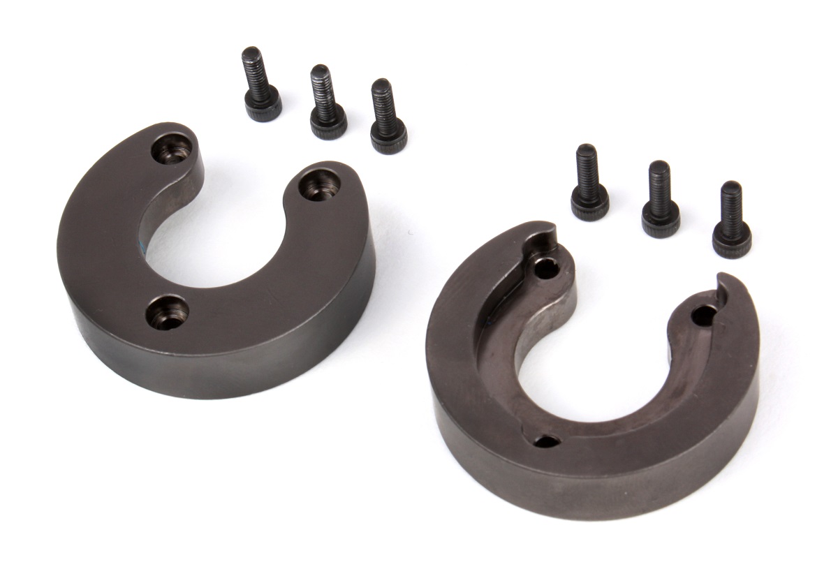

Portal Weights
You may have already spotted the portal weights. The dense brass weights add 34 grams to the front axle to press the tires harder to the terrain and increase the truck’s front weight bias. The weights fit the aluminum outer portal housings only, they’re not compatible with the stock composite housings.
Portal Weights
Installed portal weights
Install the portal weights with the longer screws included in the package. The included screws are black, but we went stainless.

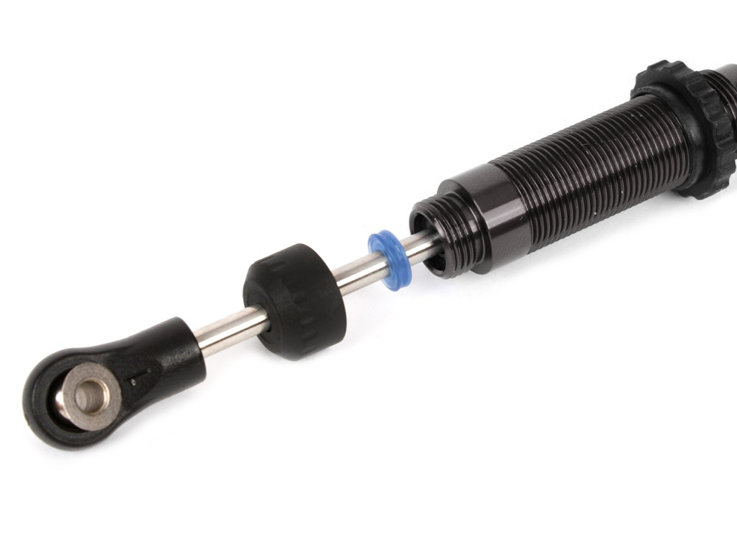

The 2021 Bronco and all TRX-4s are fully outfitted with high-strength steel suspension and steering links, metal servo arms, threaded-body aluminum shocks, and a high-torque metal-gear servo. That means our Bronco is equipped like a “full option” rig as soon as you open the box. We're taking it a step further by installing premium GTS shocks that use high-tech coatings to deliver pro-grade performance. For over-the-top steering power, we’re upgrading to the High Torque Red 400 servo. This high-tech powerhouse swings the front wheels with enough power to pull 25 pounds—not to mention digital precision and the strength of full-metal gears.

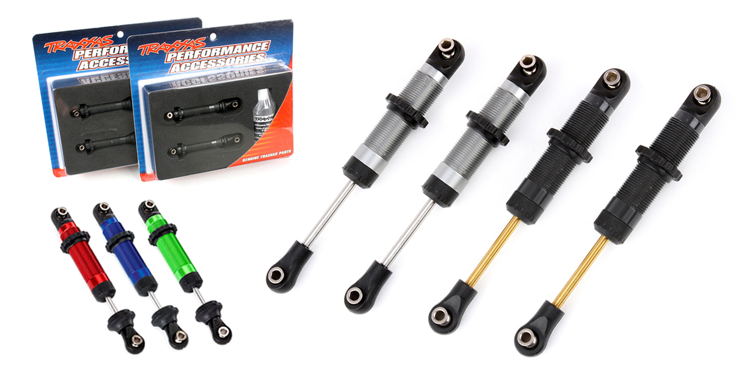

GTS shocksAll TRX-4s are equipped with silver-anodized aluminum GTS shocks, and you can get green, blue, or red-anodized versions as options. For peak performance, get the GTS dampers with hard-anodized bodies, PTFE-coated bores, and slick Titamium-nitride shafts. They’ll set you back an extra ten bucks, but they deliver longer seal life and extra-smooth action.
X-ring seals
No matter which color you get, all assembled GTS shocks include a bottle of oil and arrive ready to fill. We like to unscrew the lower cap and put a drop of oil on the seals before filling. For the ultimate in smoothness and performance, follow our TRX-4 Pro Shock Build guide.

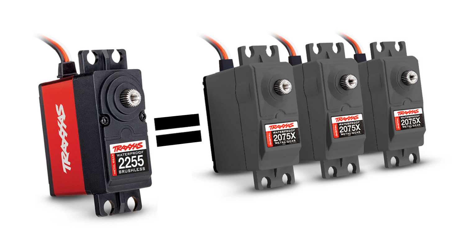

Brushless servo torque comparison
With 400 oz-in of torque, the High Torque Red 400 servo steers with more than three times the power of the stock 2075X servo (which is no slouch at 125 oz-in).

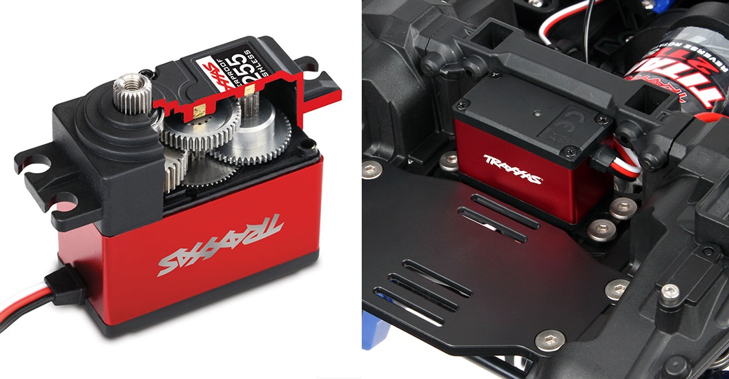

Servo installed
The red-anodized mid-case looks trick and offers performance benefits too—it stiffens the case and acts as a heatsink.

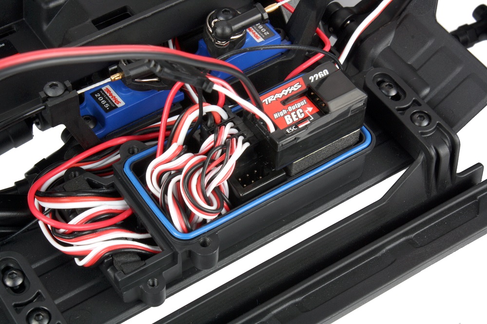

Installed BEC
The Red 400 servo works in conjunction with the 2262 High Output BEC. The BEC ensures the servo won’t drain power from the receiver when maximum torque is required. Learn more here.
